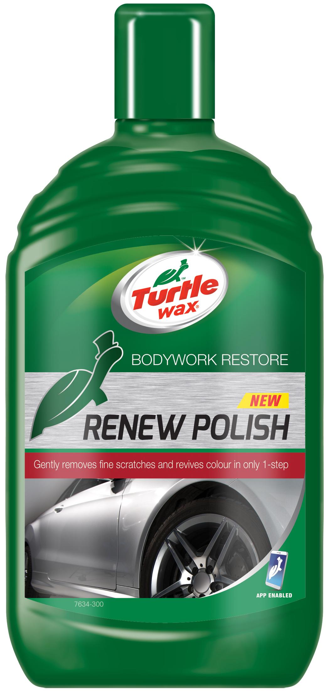

My SLK and S-class are 10 years old, I usually bring them to a shop to get waxed. This year I have the DIY equipment.
The Meguiar's Ultimate and clay bars just arrived my door. I will wash the car myself, will my cars need something like cleaner polish wax before applying the Ultimate?

Halfords | Turtle Wax Restorative Cleaner Polish 500ml
cleaners that remove oxidation, light scratches, swirls, and restores dull and faded paintwork.
http://i1.adis.ws/i/washford/297197?$pd_main$

If the car is black and you clay it you can mar the finish easily and then it would be showing lots of swirl/spider scratches. A wax will not do much to correct that, to fix that it would need to be polished.
If this is on a silver car then just clay the car, use lots of lube on the clay to stop any maring of the paint. Then do light coats of wax to protect. Most paste waxes you can build up layers of wax on top of each other.
asian_XL 03-05-2015 05:43 PM
Thanks, then I can forget about the turtle polish wax.
both cars are silver (bluish silver paint)

Clay is a must! A cleaner wax is good if you have light oxidation. If your car is in good condition, a thorough clay topped with the megs wax should be just fine.
