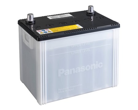

My stock one definately wasn't AGM, wasn't even maintenance free. Looked exactly like this:
http://www.panasonic.hk/usm.ashx/e/a...I1aeP6gjcL1Aoo
