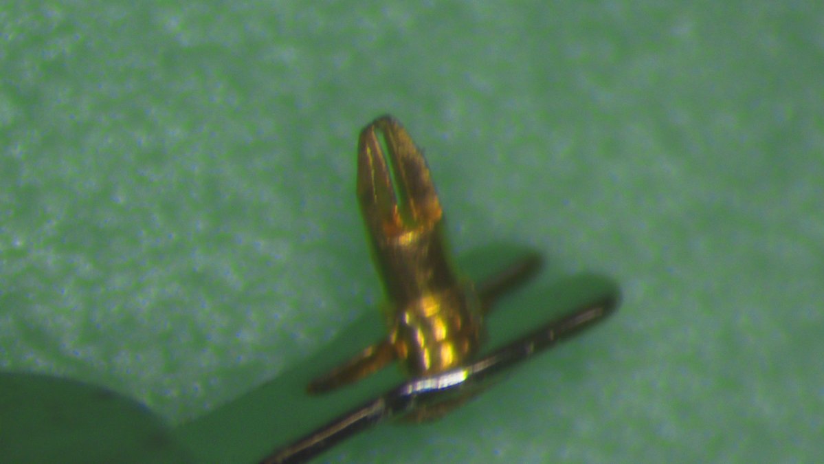

I can't remember if I shared this, but one of the first things that happened to the first Seagull ST3600 I bought, is that the balance wheel simply fell off during reassembly! I assumed I must have been too rough with it, but as it turned out, there was insufficient adhesive on the stud to keep the hairspring in place.
So into a box it went, as I continued to work on its replacement. In the back of my mind, I wanted to come back to it once my skills (and magnification) were up to the task. So I took a stab at it today, with some UV glue, and a working balance for reference.
Here's the balance cock with balance removed (well it fell out). No trace of glue on the stud:

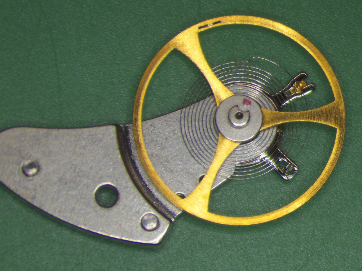

Regulator pin is closed on the end, so the hairspring will need to be slotted in from the side:
https://pbs.twimg.com/media/G-Scxl0asAEwqGc.jpg

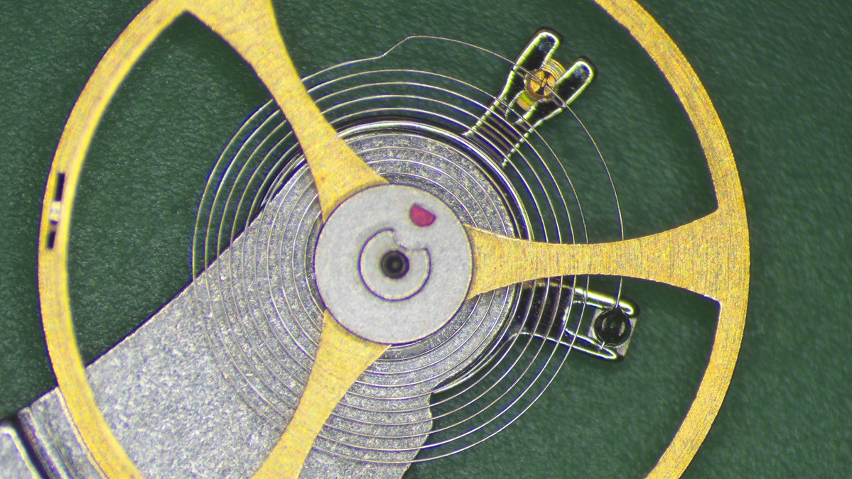

Hairspring is threaded through the regulator. I used a working balance to aim the roller jewel in the right direction, with the intention of fine tuning later:
https://pbs.twimg.com/media/G-ScpP2a4AA33Zl.jpg

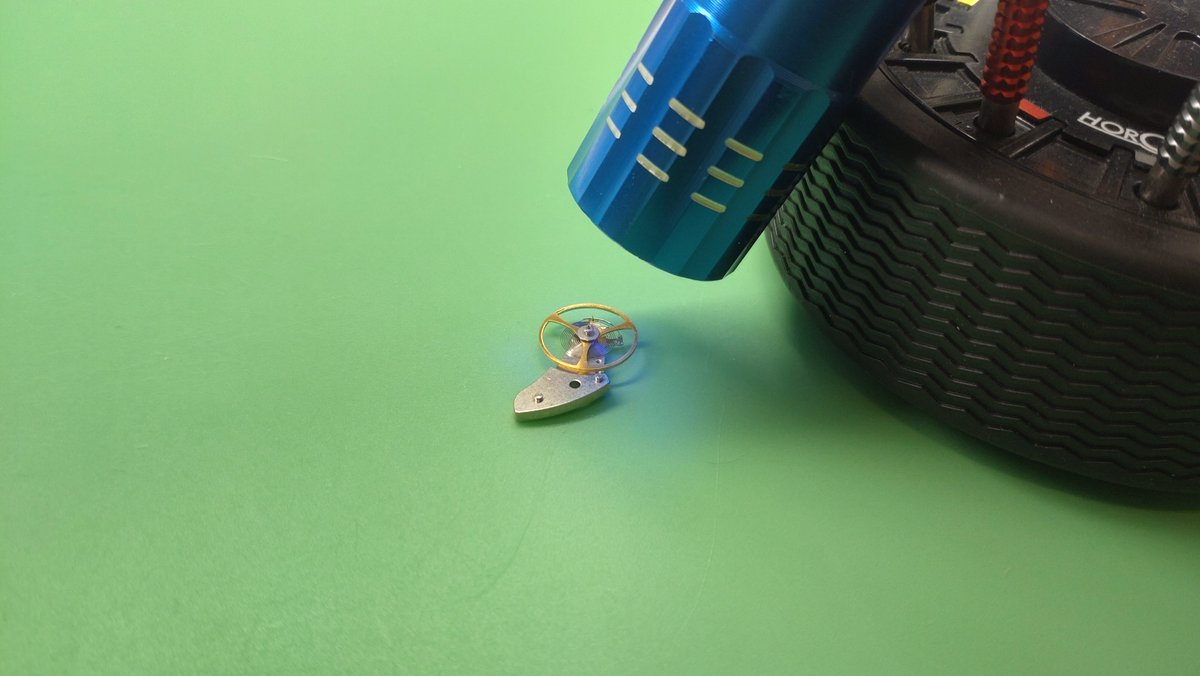

My improvised UV curing setup
https://pbs.twimg.com/media/G-ScpKIbYAA4Av3.jpg

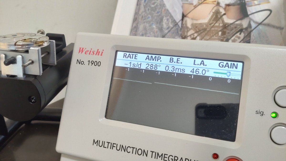

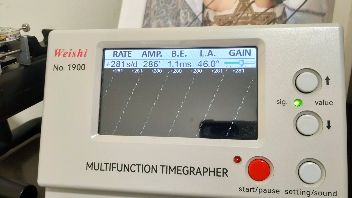

Initial timings look promising! I got it to 1.1 just by eyeballing it
https://pbs.twimg.com/media/G-ScpKJasAAU-Bp.jpg
My only goal was to get it within spec roughly in one position. I'll look at the rest later
https://pbs.twimg.com/media/G-Scxl9boAAtD8M.jpg
