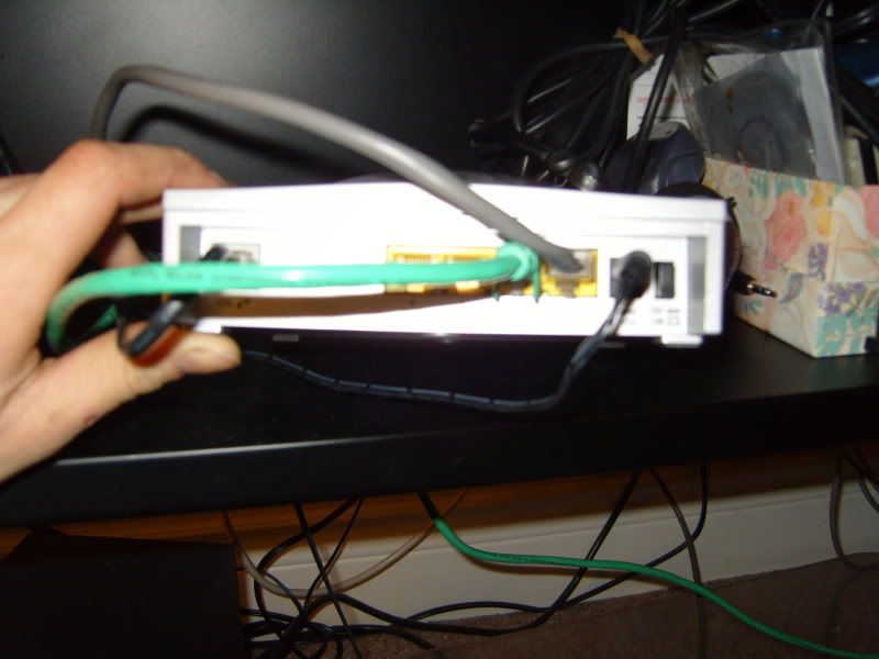

I've been having some troubles with the internet for a few weeks now and i know nothing about this stuff.
I have an HP PC with Windows XP with DSL and normally use internet explorer. One day Explorer stopped working. Every website i go to it says "Internet Explorer cannot display the webpage." So i did the usual and shut off the computer, unplugged everything and plugged it back in but got the same thing.
For whatever reason Netscape 7.2 works fine but IE will not work. I downloaded Firefox but that didn't work either. So i'm stuck using netscape only. I tried upgrading to IE8 which did nothing. I don't mind using Netscape, but since Explorer stopped working, Limewire will not connect either. I attached a couple pics of the router(?). i do have a wireless setup as well for my laptop. I havent changed anything since i first hooked everything up.
Black Wire on the far left goes into a telephone outlet in the wall.
Green wire goes into another telephone outlet in the wall. I'm guessing this is for our wireless upstairs.
Grey wire goes to the back of the comp
I don't if any of that is relevant but here are pics anyway.
In the 2nd pic there #2 is lit up with a green light, it did not show up when i took the pic.
Any help or suggestions would be greatly appreciated.
