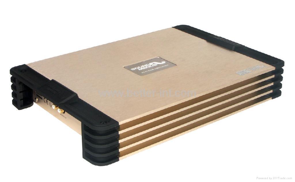

Best connectors for screwn in type terminals?
I just bought an amp which have screw down terminals instead of the traditional style made for ring connectors.
It looks like this
I was wondering what was the best type of connectors to use for these terminals?
