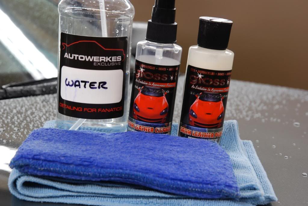

Todays Players. Gloss it Leather Cleaner and Polish, water, AG Hi Tech Cleaning Pad and a work towel.

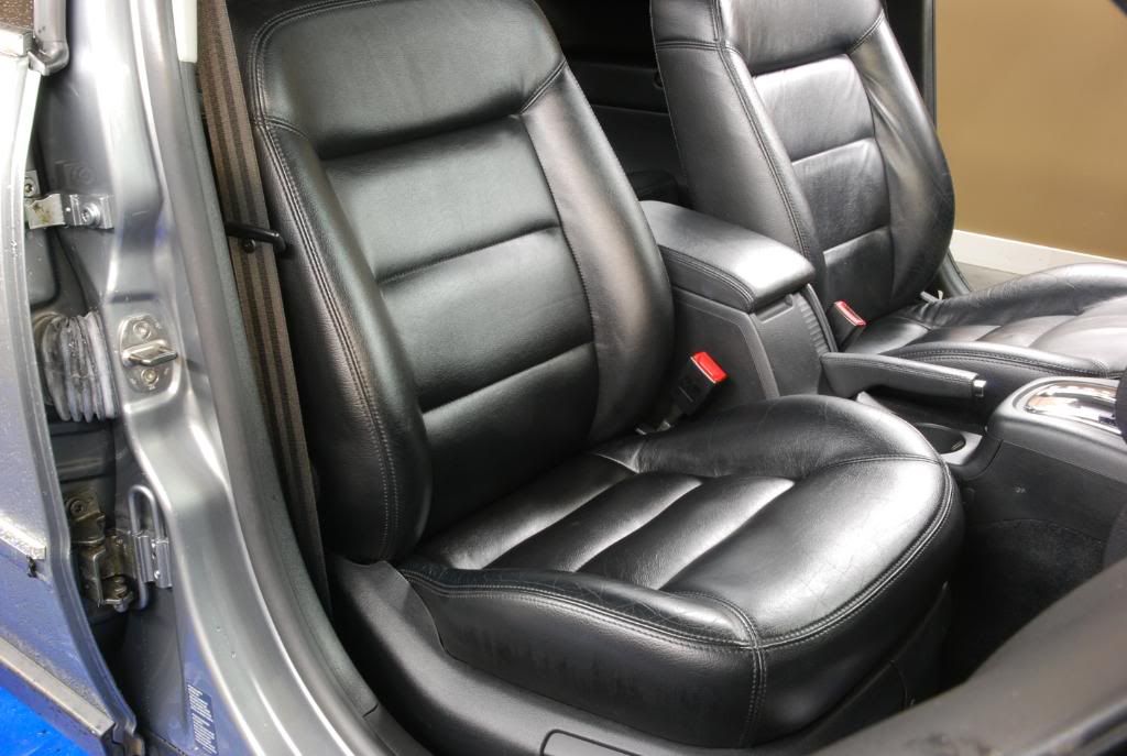

Todays volunteer.

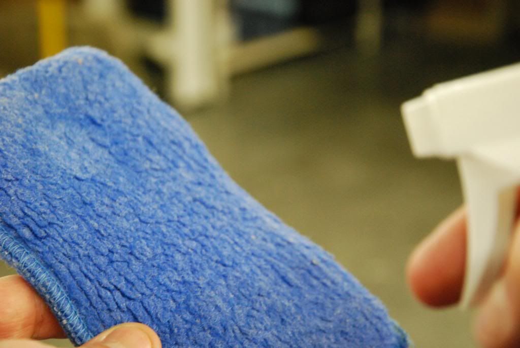

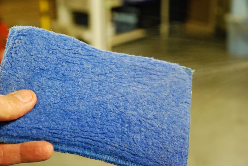

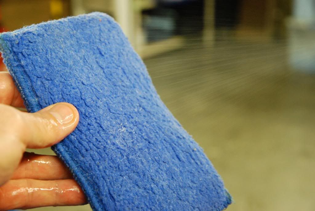

I like to spray the MF pad with a bit of water to help thin out the leather cleaner so its spreads easier.

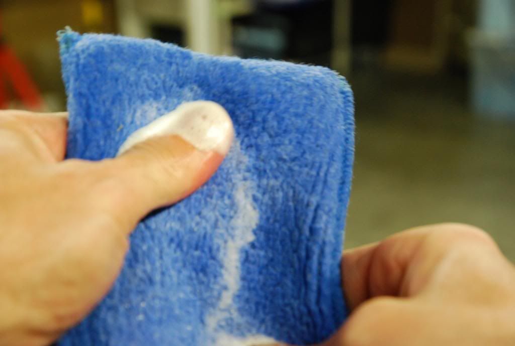

After moistening the pad, I spray a few squirts of Leather cleaner onto the pad,(to keep costs down, I recommend actually spraying it onto the pad instead of your hand as I have!)
and massage the pad to produce a foam.

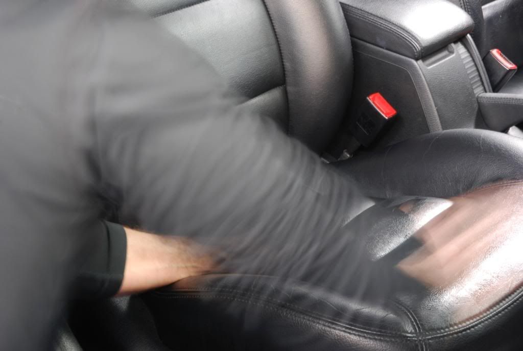

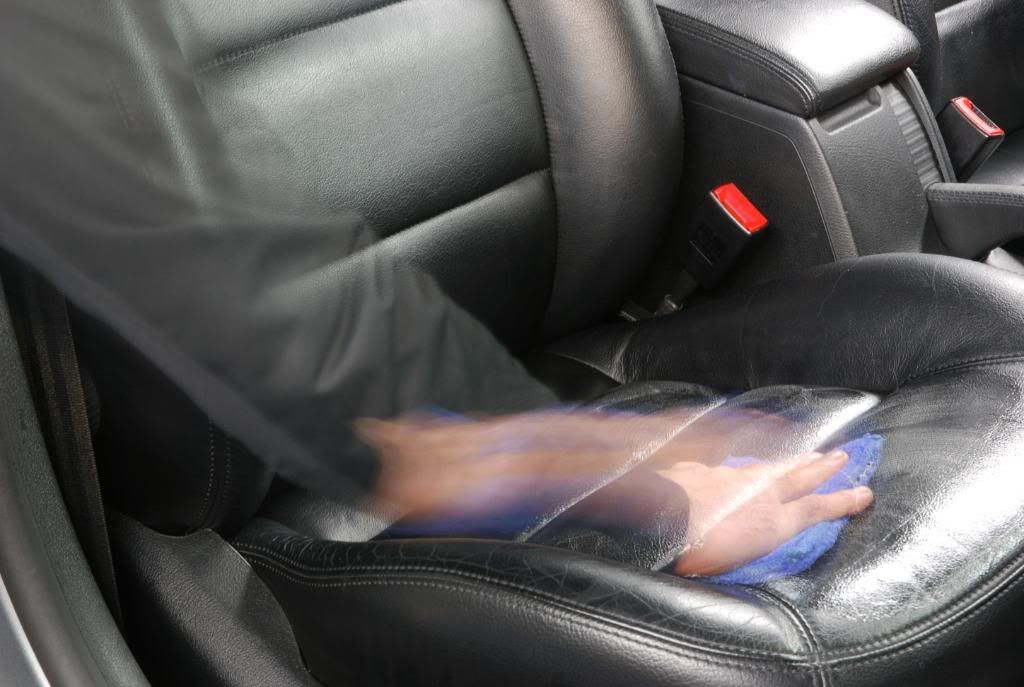

I then lightly scrub the seat with the pad. Typically, I will do mist more water and cleaner onto the pad before doing the seat back. Cool photography eh?

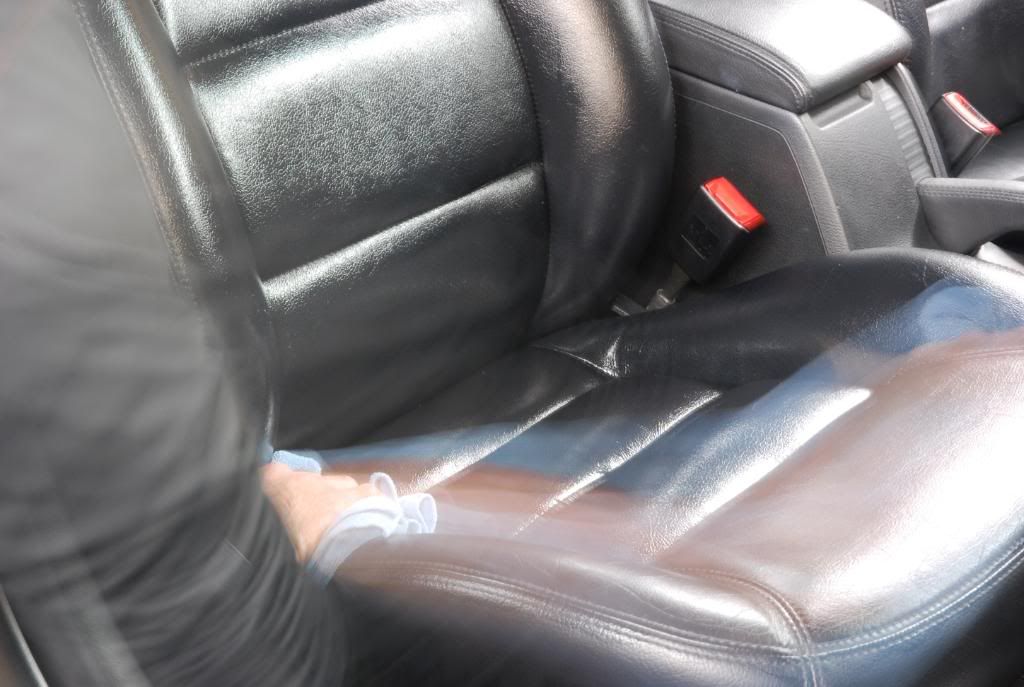

before wiping dry with a work towel. Another cool pic! OOOOOOO, AAAAAAHHHHHHHH!

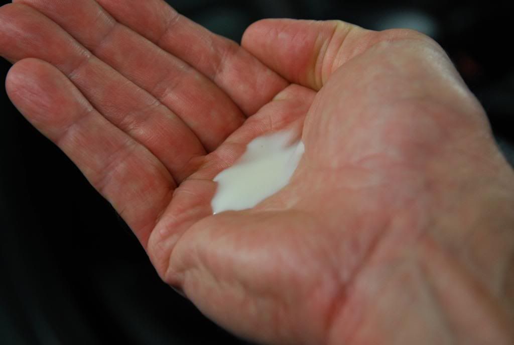

Start with a quarter sized drop of...( insert dirty remark here ) GI Leather Polish. Instructions say to use MF applicator but I like using my hands.

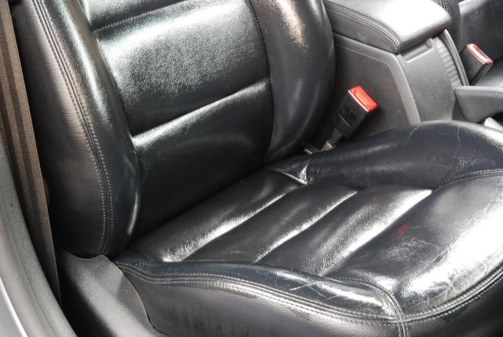

Massage into seat.
Wipe down with a work towel to prevent any streaking and admire your work. Mmmmmm.
