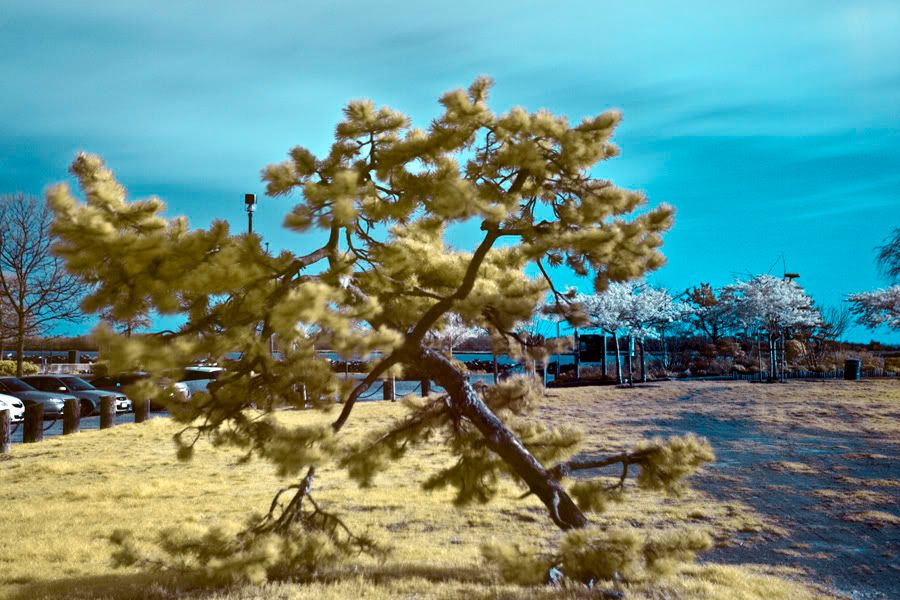

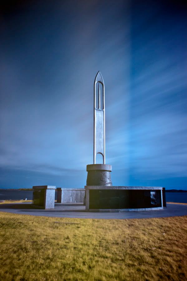

About a few months ago, i posted an IR pic on the daily showcase and Mananetwork asked me why there was a gradient on one of the photos, like this one?

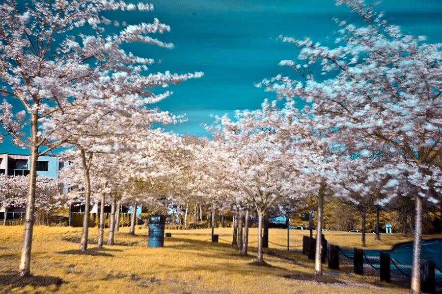

I went out the other day and since it was sunny, decided to do some IR shots. That darker shade seems to occur only during portrait shots (sometimes), and not landscape shots.
But then again, sometimes it doesn't occur on portait too.
Anyone have answers or ideas why this occurs? I'm somewhat clueless and the only hypothesis I have is that it depends on where the light source is and time of day. I doubt it's the camera (5d2), the lens (first pic posted was with a 24-105, everything else 24-70) or the filter (B+W)...

This is most likely caused by the inside of the mirrorbox in the camera. Somehow, under the right conditions, it looks as if some light or infrared light is bouncing off the top of the mirrorbox and causes the exposure discrepancy. It very well may be that the mirror isn't closing all the way in some cases, which is causing a 'lip' inside, leading to a shadow going across the top of the sensor. Maybe there's something loose that is also causing it? Remember, the image is inverted on the sensor, so anything affecting the top of the sensor will manifest itself on the bottom of the image on screen.
Does this happen only with IR shots, or with long exposures?

thanks senna, the light bouncing off the mirrorbox is what i was thinking since there's no loose part around that area and it only happens during IR photos, never on long exposures.

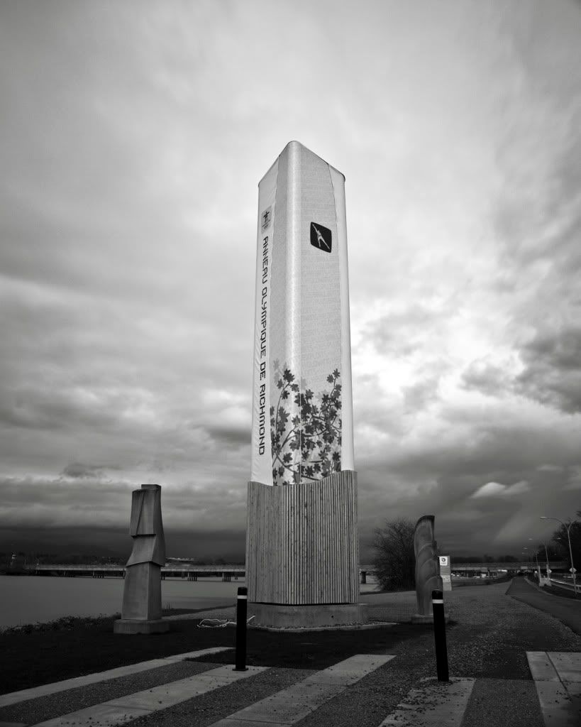

for reference, here's a long exposure shot, portrait and cropped, showing that the gradient is only observed during IR photos.
