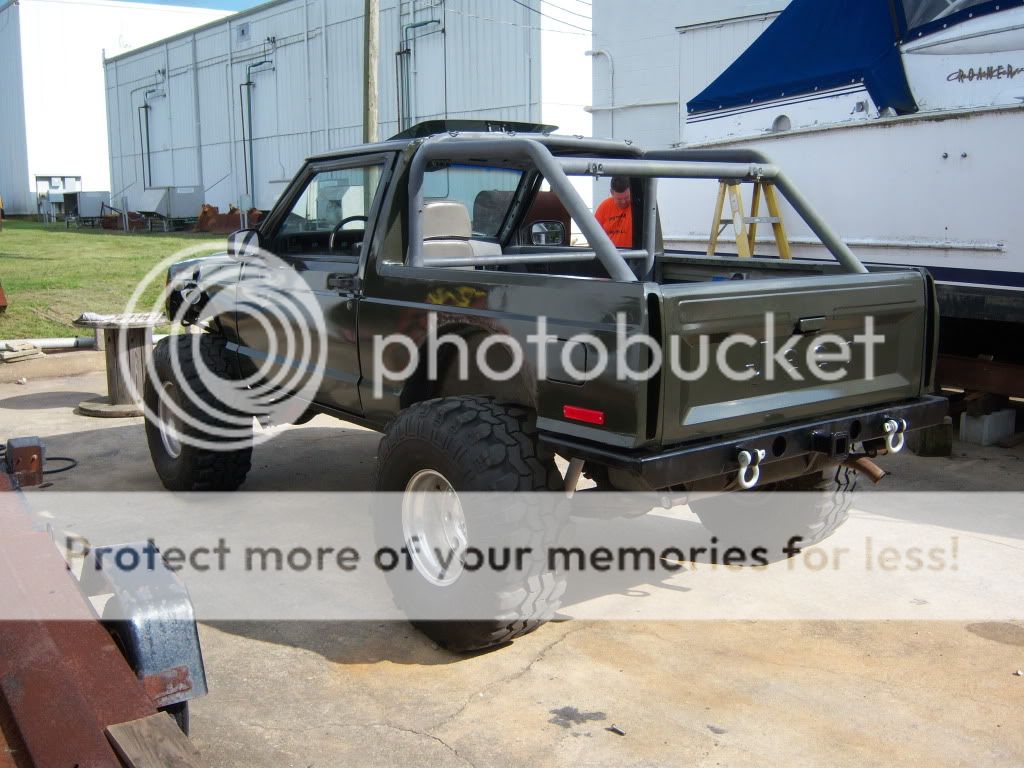

Hi, So I have a 1990 Jeep Cherokee. And I was thinking of cutting the rear section of the roof off and turning it into a truck. If I were to cap off all of my sharp edges and put a tail gate on it and do a roll bar will it be legal?
I was thinking something along the lines of this
Matt

Since it is on a frame and not a unibody, you could probably do it. You would be changing body style so you would have to notify ICBC via your Autoplan Agent and I can't recall if that would need an inspection done or not, but I think so. The Autoplan Agent should know. Being a big mod, you might want to co-operate with your choice of inspection facility before you get started to make sure that they will pass it if this is the case.
