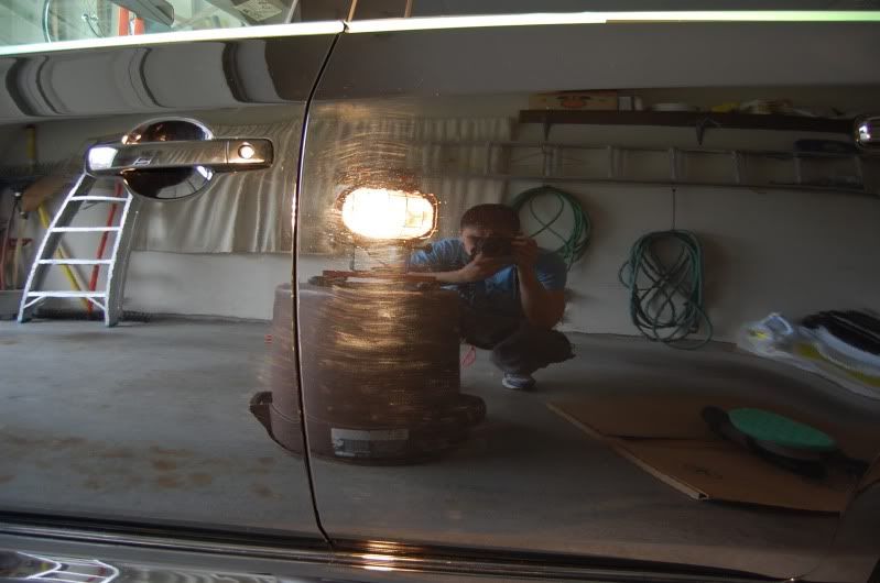

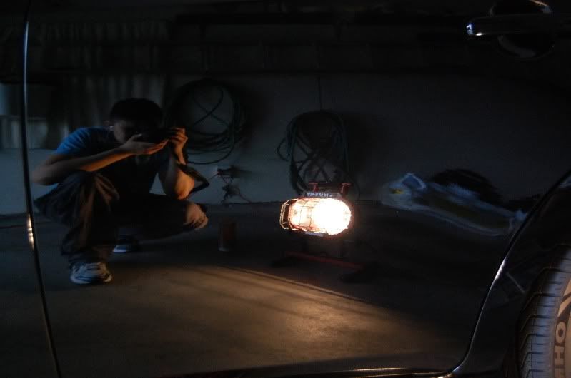

This is what my car looked like after accidentally forgetting to tell Nissan to NOT wash my car, and after the bodyshop washing the car too... *facepalm*
Also just probably neglecting the car over the winter months
After hitting it with a porter cable, orange pad + menzerna power finish
This is the only shot I was able to snap after I finished
Overall I used:
Gloss it shampoo + ONR
Auto magic(?) claybar
Menzerna power finish
chemical guys wet mirror finish
2 coats of werkstat acrylic jett sealant
