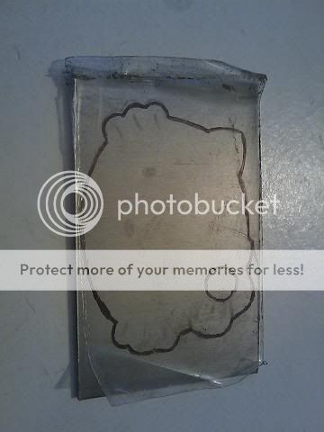

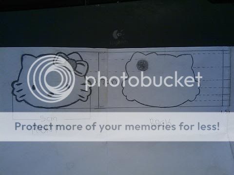

first, i planned out all the measurements and of course drew the design.. HELLO KITTY(girlfriend's got mad love for hello kitty, like all asian girls LOOL) haha, notice the "DC" in the bow tie?
then i cut a piece of sandblast resist tape and copied my design onto it

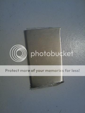

then i hacked off a piece of aluminum a bit bigger than my design
traced the outline of my design onto the alluminum. don't mind the clear cover that's on my piece. it was brand new xD

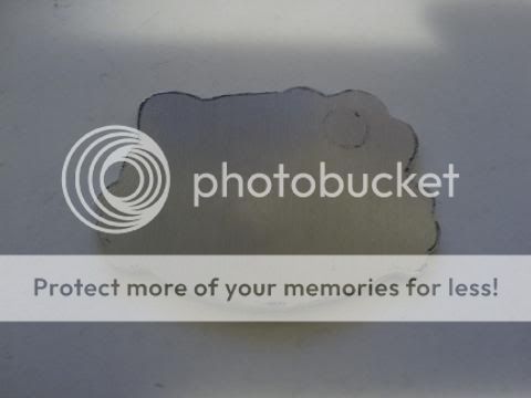

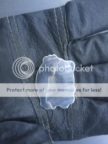

hacked off excess alluminum and filed down to the line! i used jeweller's files to get the small corners
rounded the edges and buffed it up! nice and shiny!

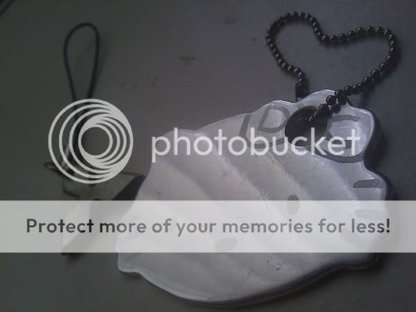

next step is the sand blasting! i used an exacto knife to cut out the design on the sandblast resist tape
the back, i just put a heart xD (don't worry about the spaces untaped, i taped them up before sandblasting):P

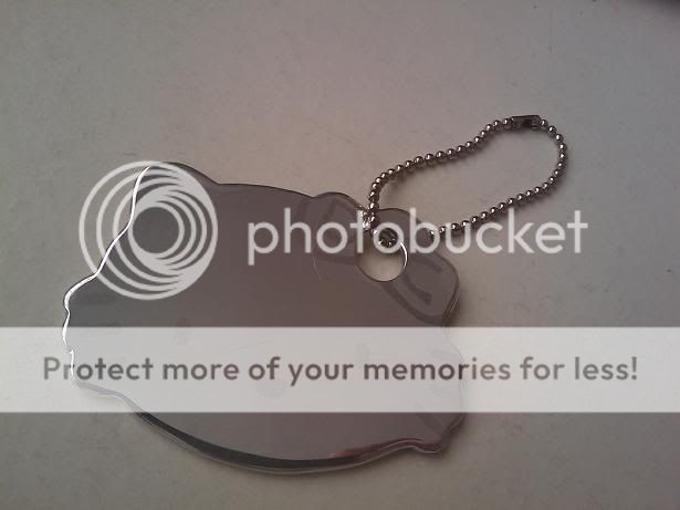

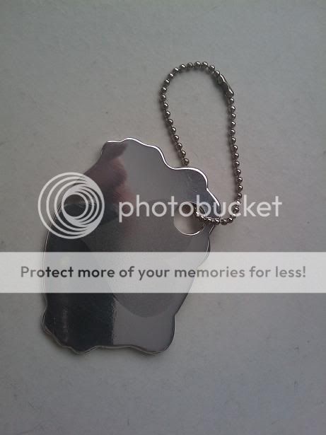

after sandblasting and final buffing, here's the finished product! enjoy
thanks for looking (: aside from homemade keychain, the gift was followed by a 10k white gold necklace of a heart with 5 diamonds in it

shoulda put your name in the heart

yeah i was thinking of that, but it's hard lol. so i just put initials in the bow =P

Cheap aluminum is crap when the keys are stronger than it, it will scratch up. Shoulda done stainless.

maybe next time i'll use steel? and i actually have it here right now, looks nice still! she doesn't carry keys in her pocket, always in her purse:P it's still in good condition only a little bit of scratches, thanks for feedback

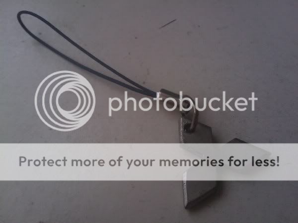

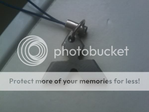

here's what i've made from a few years ago. this was actually an assignment when i had power mechanics class haha.
for those who are interested: you'll need to carve out a design into a piece of cuttlefish bone as a mold. then get a spoon with a chunk of alluminum in it and melt it with a small propane torch or whatever you got that's hot enough. then simply pour th liquid into the mold, and wait for it to cool down. then file down the imperfections and make it all smooth
i just made a simple logo, so here's a mitsubishi keychain!
and here's the hello kitty one too, only a bit of scratches but looks good still
