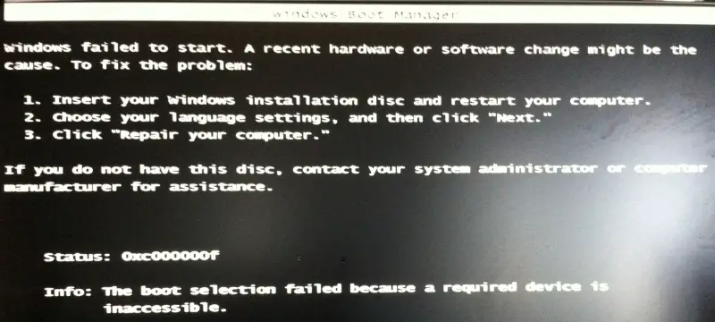

here's my story:
I bought a Corsair Force GT solid state drive 120gb becuz i wanted a faster loading windows n programs. I installed windows 7 and all the programs and everything went smooth. the next morning when i turned on my comp i get a message saying "windows failed to start" with an error code "0xc000000f".
when i checked my bios it did not detect the ssd at all. I unplugged my ssd and plugged it on a different sata port. It worked again for awhile. then one day i turned on my PC and bam, it gave me the error again and BIOS couldnt detect the ssd. had to unplug and replug the ssd in order to work.
anyone have an idea why this is happening?

what kind of error do you get? i get this error:
