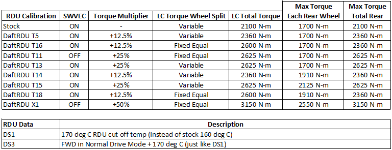

Finally got around to tuning the AWD and ABS in the RS. Went with the T16 version which keeps SWVEC on, but locks the rear diff for launch control. Ups the rear bias of the system as well. Reallt changes the dynamics of the RS.
Also as a bonus, flashed the ABS.... so when you’re in drift mode, the handbrake sensor triggers the rear ABS pump, disengages the centre diff and locks the wheels = hydro e-brake

Whoa rear diff is active until 340f? That seems like it would COOK the diff fluid, wouldn't it?
Also have you noticed it going into fwd mode much? Rear diff cooler in the works?

I’ve only ever had the RDU (rear drive unit aka e-diff) shut off once, it was the last session in the August Ridge track day (35°c ambient temps). All other track days it’s been fine.
As for the temps, it’s actually an inferred temperature from the centre diff (PTU, power transfer unit) as the RDU doesn’t have its own sensor. So even if you add a diff cooler, if the PTU gets hot it will still shut off the diff. Stock temp limit is 160°, which I trust ford to extensively research.
