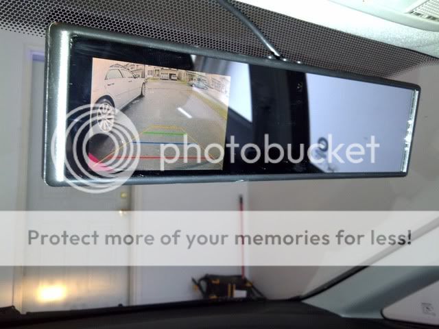

I have installed several backup cameras in several different vehicles and hooked them up to a rear view lcd mirror. If your vehicle has a self dimming rear view mirror, that is about the only feature you would lose.

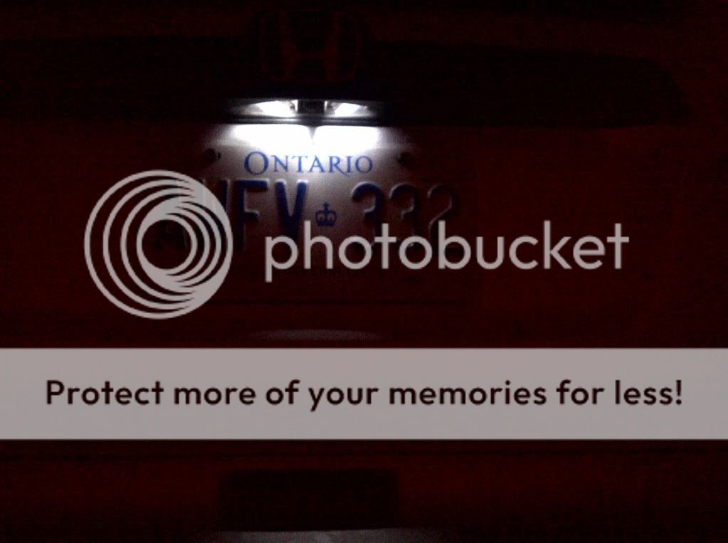

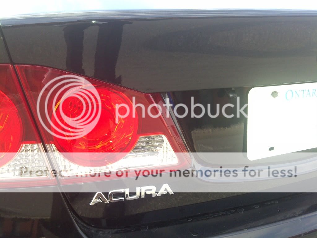

I've found the led on the oem style camera's for honda/acura tend to be on the dim side. Generally the camera will replace one of the license place lights.
Here is a example from my dad's old CRV
The light was very dim. I even added aluminum tape in the area to act as a reflector and it didn't help much.

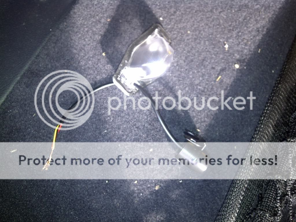

A better alternative is to get a small camera, and run the wire through or behind the license plate light. This is exactly what I ended up doing in my dad's CRV afterwards, another Honda van, and the wife's CSX.
I cut the wire about a few inches from the camera and ran it through the hole I drilled in the light, and reconnected it. I have not had any problems with this approach.
Here are the back mirror w/ lcd that I'm talking about
The last one I used in my 300c also had built in bluetooth and caller id showed up on the screen, and was quite visible in the daylight.
