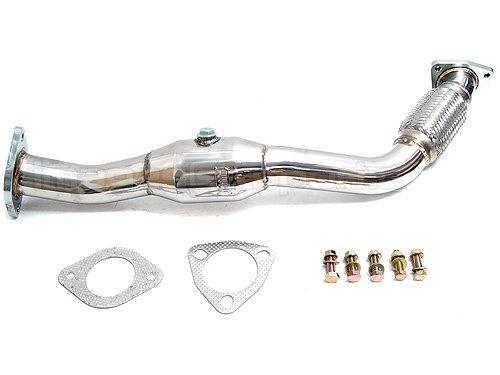

Old 02-27-2014, 03:20 PM   #20
Grim's Avatar
Location: B.C
Posts: 1,659
Failed 358 Times in 70 Posts
hmmmm.......
should i try replacing the cat?
or maybe get the megan down pipe that comes with a precat / cat?
btw: my cat convert light blinks for like a bit every time i turn on the car then goes away....
maybe it is the cat deficency
this is the OE pipe i bought and installed. I looked at the Pre cat prior to install and the pre cat condition looked good.
mind you, i am a complete noob.. so i could be very wrong and wasted 50usd on that stupid OE pipe
