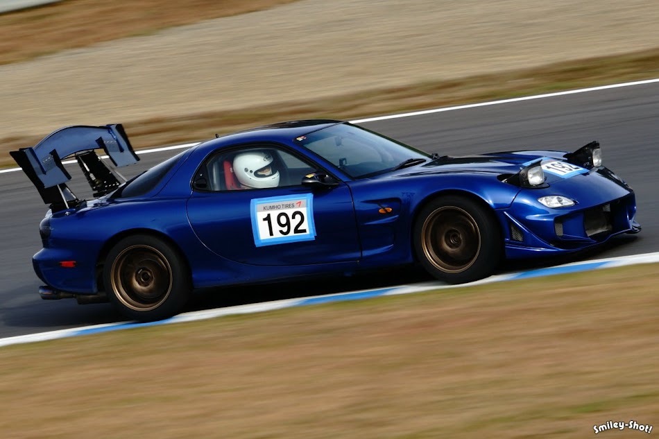

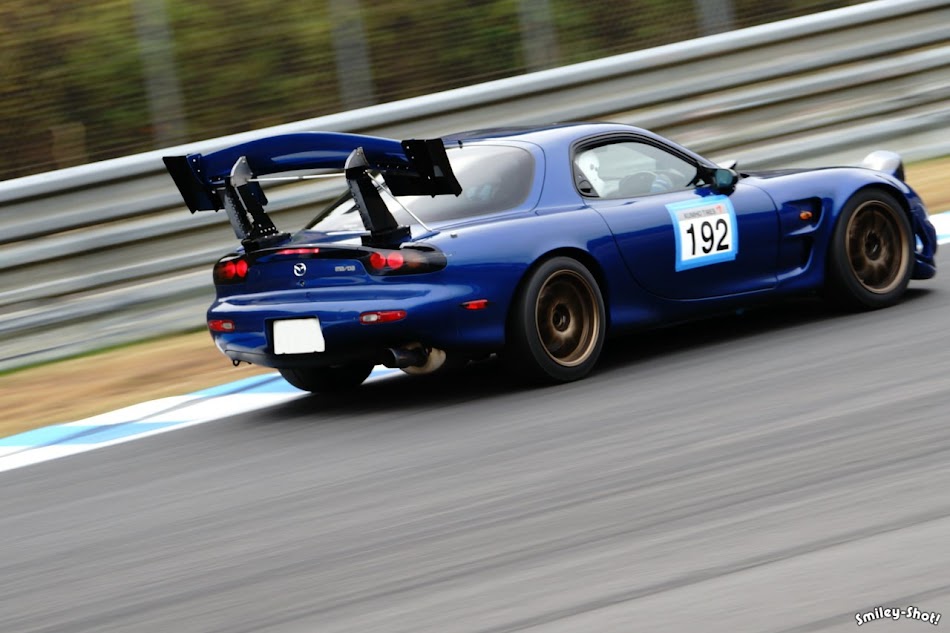

yea gigantic wings sure have existed already, some of them wider than stock body, but they were heavily modified.
simply putting gigantic wing on a bone stock car doesn't make much sense.
Originally Posted by white rocket View Post
What aspect of your design makes it superior to what is currently available? What's the gimmick basically? 'cause without something to differentiate you from the pack it'll be a tough sell. Not hating, just sayin'.
yeah that's what I was thinking too... other than the gigantic size, it's nothing new

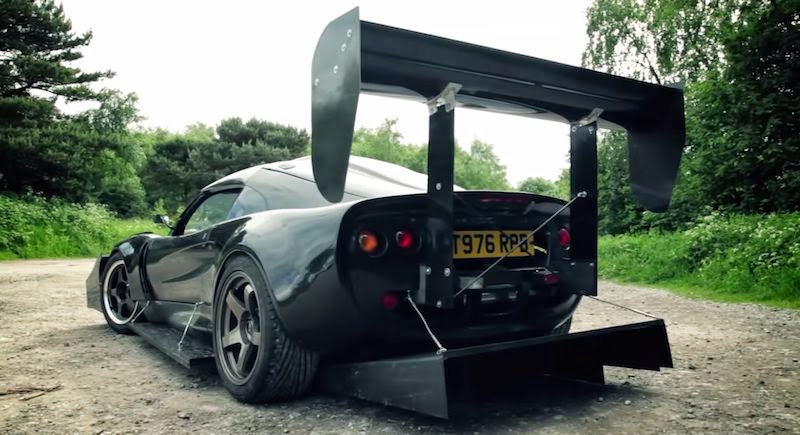

for a wing of that size, if you're looking for some innovations, I would at least make it active.
Bugatti Veyron, Porsche 911, Mitsubishi GTO, Toyota Supra(front lip), Lexus LFA, McLaren P1, etc....they all had active aero system.
