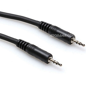

You could also use the current monitor, use an HDMI-to-DVI cable for the Optik box, then get a set of speakers with two inputs and run the Optik box's Audio Out jacks to one input via RCA-to-miniTRS cable, and miniTRS male-to-male cable for the computer output.
Connect Optik HDMI out to monitor DVI in:
Dual-input speakers:
Connect Optik audio outs to speaker Aux input:
Connect computer line out to speaker Computer input:
