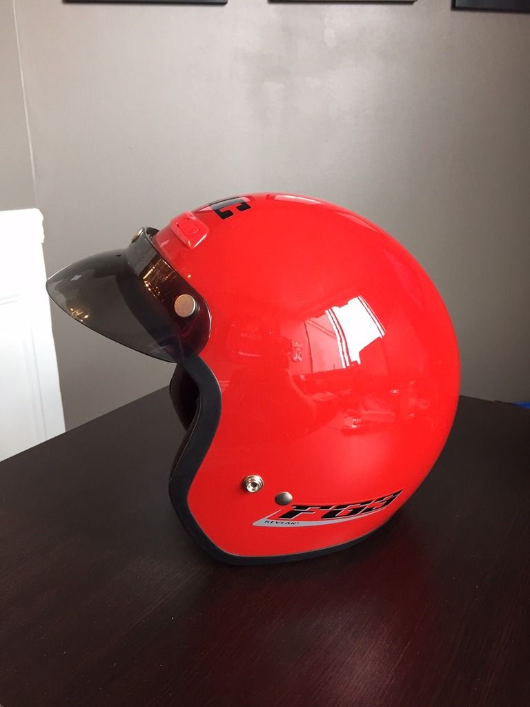

Hondaracer 03-28-2016 07:37 PM
if your head is a L i've got this helmet for sale, brand new, $50
http://i4.photobucket.com/albums/y13...r.jpg~original
http://www.revscene.net/forums/70346...le-helmet.html
