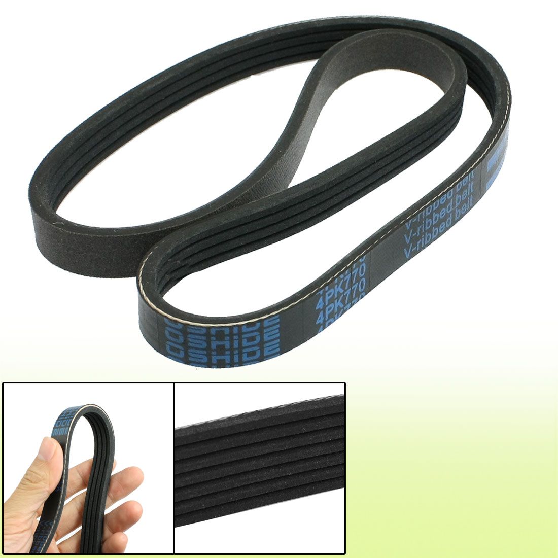

Something the occurred to me is that it could be the accessory belt that went and the guy is just trying to screw you. What happened when the car broke down? And did the belt look like this:
(grooves running the length of the belt)
or like this?
(grooves running across the belt)
