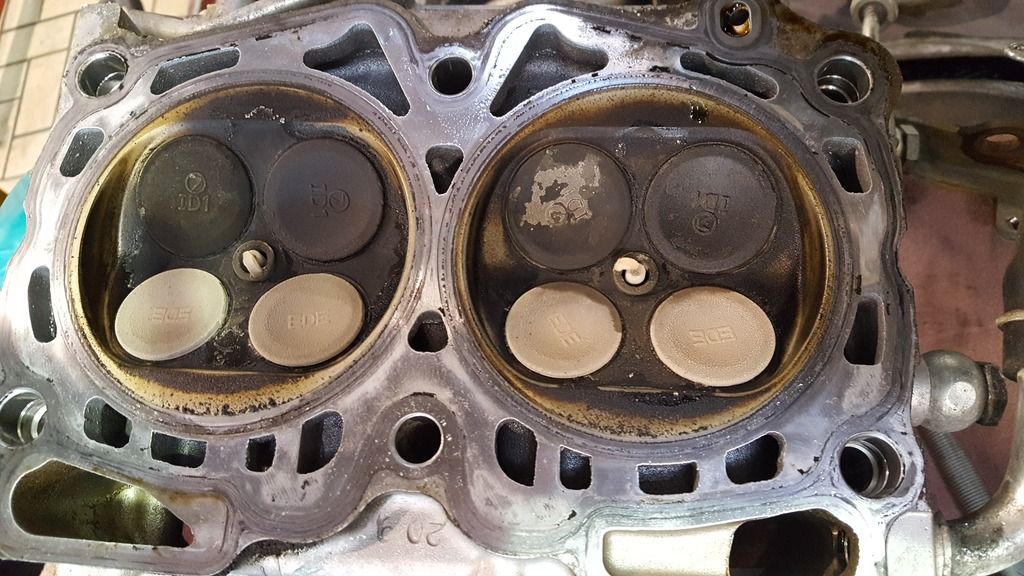

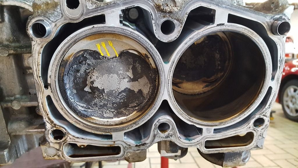

Update:
Cracked piston on #2 cylinder and also rings were stuck
Short block replaced under third-party extended warranty.
http://i793.photobucket.com/albums/y...p.jpg~original
http://i793.photobucket.com/albums/y...x.jpg~original
http://i793.photobucket.com/albums/y...0.jpg~original
Just got back my car few days ago.
Dealer now started using synthetic oil in my new short block ORZ, so should I change to conventional oil for break in period?
