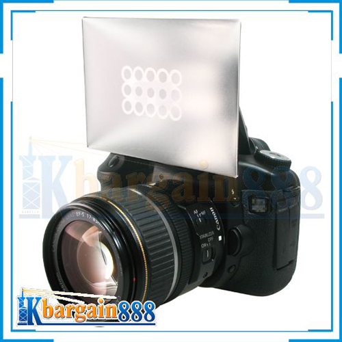

regarding flash and lighting, what are your feelings around using those ebay diffusers for the on-camera flash?
Hot shoe flashes tend to be a little bigger than my liking

^^ Those will help a bit, but because the original light source is so small, there are only very limited things that can be done.
