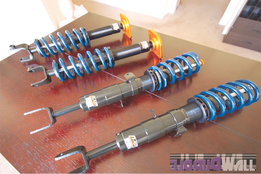

StanceWorks just recently teamed up with AST to create a brand new setup called ZeroClearance, made specifically for slammed 350z's and G35 coupes...
I'm on the list to receive one of their first batches soon as they're released.... and now I know who to go too for corner balancing and suspension tuning, wicked!

now here's a man who knows a little something about suspension.
AST's are king!
i believe that S54 engined E36 has that AST/Stanceworks coilover setup too
