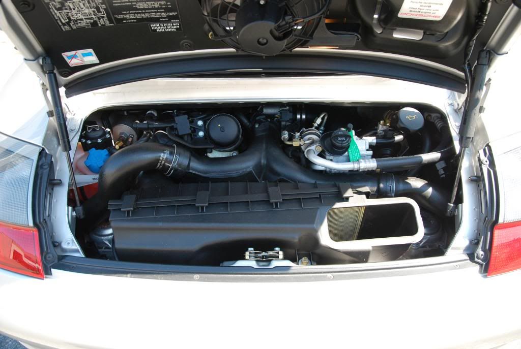

It's been a while since I posted any of my work as things have been a wee bit busy. This Client was given my number by his neighbour 4 MONTHS ago. Its an 04 Turbo Cab with the factory X50 motor option - makes 440hp. 0-60 is supposedly mid 4 seconds which I will attest to during my own little test. Holy crap is this thing fast! Client picked it up last year. Car presently has 25,000 kms on it ( approx 15,000 miles )
All jambs, motor, emblems etc were cleaned with a citrus cleaner and RG brushes.
Car was presoaked in citrus cleaner to get rid of any remnants of a previous LSP and rinsed.
Washed with DG901 Carwash soap and RG wash mitt.
I didn't clean the wheels at this point as they were really bad and I knew I'd be removing them. When the time came, the barrels were carefully cleaned with a mild acid based cleaner and washed down with soapy water to neutralize any acid remaining. The faces and tires were cleaned with AG Custom Wheel Cleaner.
Inner fenders, suspension etc were cleaned with AG Powermax3 mixed 4:1. Inner fender liners were dressed with Gloss it TRV.
Exhaust tips were cleaned with P21S Polishing Soap and dressed with Blackfire All Metal Sealant
Paint was cleaned with Exclusive Medium Clay
As the paint was in great shape other than a few scratches on the passenger side, I thought I'd try the New Optimum Spray Polish. Worked o to remove light carwash damage but even with the GI Yellow pad, it couldn't remove the light scratches that were present although it did hide them a bit. Menz SIP on the same pad got rid of the scratches completely.
After polishing with SIP/Uber Green and my PC, the car received 2 coats of Gloss it Gloss Finish.
Wheels were finished with Blackfire All Metal Sealant and Tires were dressed with Swissvax Pneu.
All exterior trim was dressed with Gloss it TRV.
All glass cleaned with ShowroomFX glass cleaner.
Interior was wiped down with AG Interior Shampoo and seats were cleaned and conditioned with Raceglaze.
TOTAL TIME - 12 hours

Engine cleaned and dressed with AG Silicone Spray
