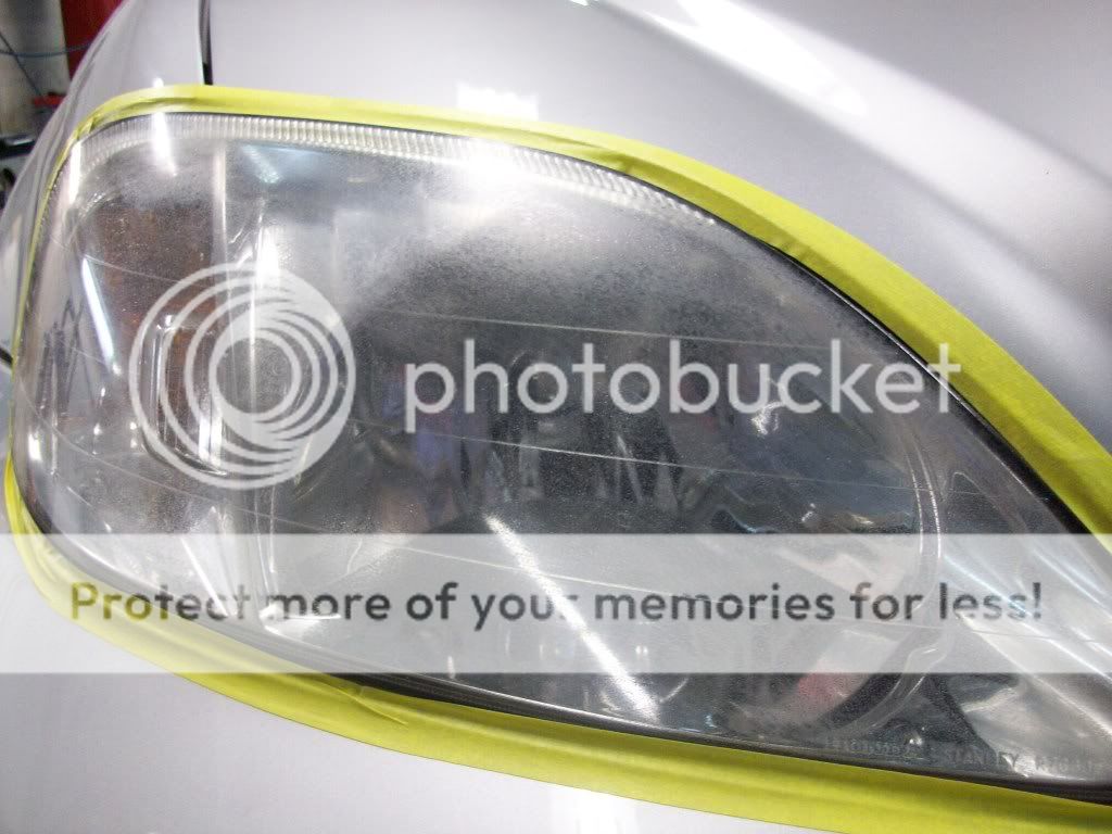

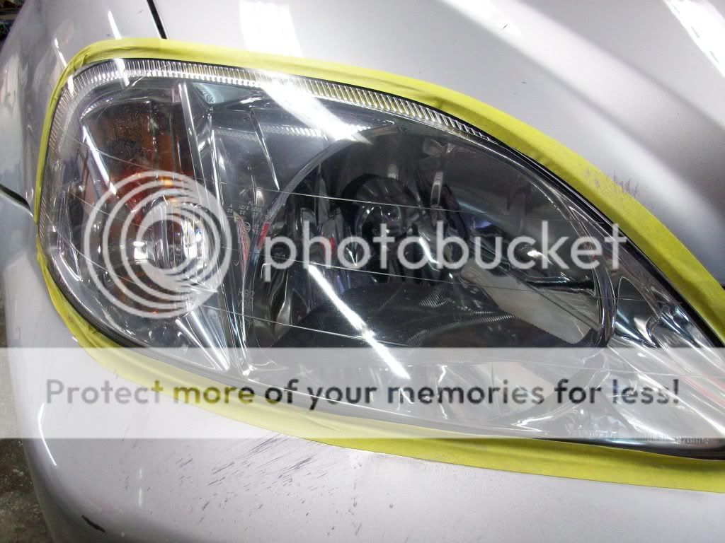

what do you guys think

^Looks good but did u scratch up your bumper during that? >.<

^ LOL looks like it
but i hope not ..

LOl no thats polish all around the headlight. forgot to wipe it off before i took the pic
