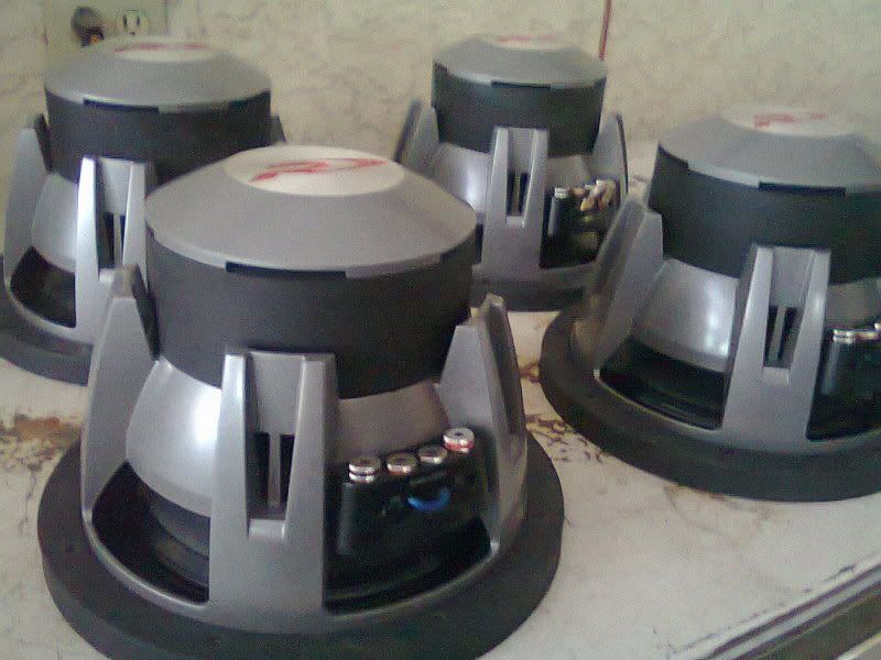

I'm getting confused between wiring my subs parrallel vs series.
I have 4 alpine type r's wich are 2+2's, and a kicker 1000.1 monoblock. Kicker amps are not 1 ohm stable so I want to run the subs between 1.5-2 ohms. Is this possible??? I will also consider running only 3 subs if this changes anything. No sorry, running 2 amps at this time is not possible
I would prefere to run only 3 subs... dont feel like making another box for 4

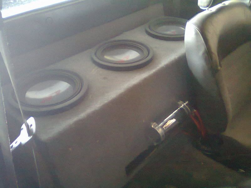

Well here are a few pictures of what I came up with. Made a slot ported box, mounted the amp under the box in a compartment, I am running the subs at 1.3333333 ohms and its hooked up through a 1 farad capacitor. I did the "big three" under the hood and so far so good. Officially the most bass I've had yet and I've got a 4th woofer for a spare When the amp gives out, I'll look for a 1ohm stable amp... but in the meantime I've got an expensive amp that I'd like to use. I think I may run a aux fan in the compartment for the amp but I'll see how it does. I dont plan on using it past 1/3 volume
(sorry no install or amp pics. Good shopping list for thieves
