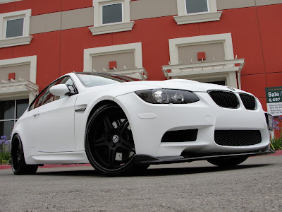

I am getting a new body kit for my car, instead of paying to paint the parts, I think covering the whole car with matte white vinyls will save a bit of money. People say it's pain in the ass to wash matte colour and no way it can go into the auto car wash.
How do I wash a car like this?
