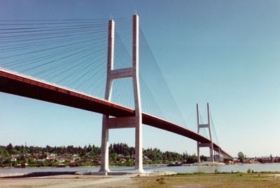

The failure in design is that the cables go over the bridge deck in an angle, thus ice raining onto cars below.
While the Alex Fraser cables may ice up also, the cables are parallel to the bridge deck.

It's not a logical oversight or an engineering problem. It's a well-established fact that LRT systems are susceptible to snow and ice, but ideal solutions break the bank, and transit projects don't have unlimited funding, so the engineers settle on a system that is great 350 days of the year, and less than ideal the other 15 days. It's no different than roads or airports, people who travel by means of those corridors experience the same delays due to snow and ice.
95% of the time this bridge's design is not causing any problems. The other 5% it costs several million dollars and a few lives. Perhaps that cost spread out over the lifespan of the bridge is cheaper than another Alex Fraser bridge. No doubt there could be a cost benefit there.
But what is clearly evident is there is a major design flaw with the bridge. You don't need to be a P.Eng to put two things together:
A- The bridge's cables stretch over the road, and ice chunks is falling from these cables
B- There is a significant number of accidents related to falling ice chunks, relative to other cable bridge designs.
Now if we put A + B together, and a little bit of common sense, we can see that most likely this bridge design is flawed. If it has webbed feet, a beak, quacks like a duck, looks like a duck, etc etc, then unless you want to look like a total smart-ass/troll, call it a duck.
Yes! This is clearly evident. No need to be a P.Eng to see this.
Now a devils advocate to common sense would say "well how come the wind doesnt just blow the ice over on a straight-cable design onto the roads". Well I would say look at the icicles and ice sheets... they have a very thin and flat physical form. Common sense would dictate anything thin would not be blown around by ambient wind that easily (eg, drop a fishing weight off a tall building, it will land a reasonable distance from where you were standing).

I'm not a bridge engineer, and I'm assuming you're not either, so it would be presumptuous to refer to the bridge design as flawed. It doesn't take an engineering degree to recognize the decision to extend the cables above the deck was made after cost-benefit analysis, and the design may offer much improved safety during an earthquake or some other incident this audience simply does not have the education to be aware of.
The Leonard P. Zakim Bunker Hill Memorial Bridge in Boston.
Boston is prone to severe snow and ice storms, but the only stories on snow and ice falling from cables causing damage are related to a 2005 storm. That should support the explanation of this incident being caused by an extremely unlikely series of events, not considered worthwhile by the government or public to pre-plan for the possibility of occurring. The deck of this bridge also appears to be very wide, and since the new Port Mann is the widest cable stay bridge in the world, it stands to reason that the layout of cables may be required with an increase in size on that axis.
