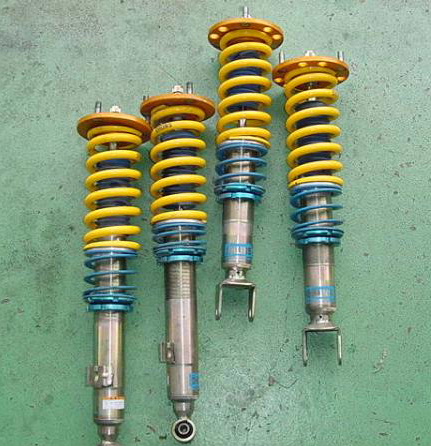

You suspension experts correct me if I'm wrong, but won't adjusting that spring that the OP is trying to break loose in the video mess with his preload?

∆i think that's for those with 3 rings. The ones I got only have 2 rings and I can't adjust my preload
Nope.
He's just drooping his suspension by lowering his car with that particular coilover setup.
To preload his springs, he would need a fully threaded body with a seperated mount. Like this.
With that setup, the springs will always be preloaded at 0+. Meaning upon installation; assuming that the spring spins freely, his preload and droop is at 0. Height adjustment is achieved by threading the shock body down, and is locked in place by the bottom collar.
AFTER desired height is achieved, spring preload can be increased from 0 by compressing the spring via the spring perch and lock collar. At that point, Droop will be at 0.
To increase droop, do the opposite. Lower the spring perch. Preload will be at 0.
If you're going for hellafail illest fitment, and you've fully extend the body BUT you're still not low enough AND The bottom of the shock body is hitting the inside of your wheel.... add droop.
Add preload if your springs aren't stiff enough, and you're too cheap to shell out $400 for a set of SWIFT springs with desired spring rate.
What is droop?
What does preload do?/Spring rate/Length
Tender springs?
TL;DR Long Hair No Care. Long post/Didn't want to read my drunken babble after wings night.

"I feel like my car should be lower!" 45 minutes later I'm 2 fingers lower all around. As for the heating up your rings comment. Please don't. Shocks are pressurized. Pressurized things can blow up when you don't know what you are doing. Judging from this thread, you need to not play with fire and pressurized things. Take your wheels off, PB blast the threads, then spin them down. Anything more is overcomplicating things.

Also, the pressure of the springs against the upper collar make it really hard to spin, even if the threads are loose and the locking collar is way down the threads. A spring compressor even to only compress them half an inch make life so much easier.

You want to lower the car right... aren't you turning the top ring in the wrong direction? :S I may be wrong, but looking at your video when you were turning the bottom collar the other direction you were trying to turn the top one at, it moved down. So technically aren't you trying to raise the car by turning it that direction by compressing the spring even further?
It's a hell of a lot easier to adjust the coilovers when they're new lol, and with the wheel off your car. I still had to use a considerable amount of force to adjust my brand new Tein basics after they've been on for a few days, with the wheels off.
Make sure you lock the rings together before you lower the car and start driving
