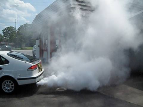

u can fill it too the max fill line when its cold and the expansion when its warm should not over flow when it warms up "thats why there is a max fill line"
if u notice it going down after a few days you have a leak or you are burning coolant "headgasket"

if it is burning coolant, would it be blowing white smoke from the exhaust? it's sort of hard to tell right now because of the cold weather but i don't see any lingering white smoke or residue on the exhaust tip.

if it is burning coolant, would it be blowing white smoke from the exhaust? it's sort of hard to tell in this weather because of the weather but i don't see any lingering white smoke or residue on the exhaust tip.
burning coolant has a distingtive smell, also if you are burning a little bit i doubt you would notice, but if the headgasket was gone.. you would know!

omg!
um... nope don't have that.
but after a long hard drive you do get a smell of hot coolant from the engine after it is shut off.
