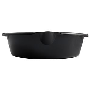

Pretty much, I use an oil pan like this as I prefer a pan that is a sealed container
http://s1.cdn.autoevolution.com/imag...-2-53291_3.jpg
You'll need a tool set obviously. It would be helpful to get the correct size oil filter adapter/wrench to remove your oil filter, vs using those generic band style filter wrenches. Consider picking up a magnetic drain plug if you don't have one already.
I don't bother buying my oil in the states anymore, maybe if I'm already there. When oil is on sale at Crappy Tire, it's around $30-35 for synthetic 5W20, which is close to the price in the states.
Good idea to pick up a factory service manual for your car if you decide to start DIY'ing.

CCA-Dave 02-25-2015 10:34 AM
Funny enough, I was thinking about starting a thread for things I wish I had learned from the beginning when it comes to tools and car maintenance. The simply oil pan is one of those items.
I, like most people, started out with the "enclosed" oil pan as linked above, and in the spoiler below. You'd think it's an elegant solution, with everything "all-in-one", and in theory you can drive the unit to Canadian Tire and have them dump your waste oil without ever having to transfer containers yourself. In practice, however, that evil son-of-a-b**** becomes an oily, dirty mess which is almost impossible to clean and leaks everywhere. 1) The plastic is cheap, and the threaded caps don't seal very well. 2) The black portion of the unit is texturized, so if you do get oil on it (inevitable) its almost impossible to clean. So, you end up storing the thing in a garbage bag, and every-time you use the damned thing it's an oily mess.
A number of years back while buying oil, I figured the hell with it and bought one of these oil pans for $2. At the time I figured I'd just throw the damned thing out if it was a messy disaster. I think I own five or six of them now. They are smooth plastic, so with about three squares of the blue shop towel I can have it almost perfectly clean, a quick spray of brake clean and a 4th square of blue towel and it's perfect. The six stack together, and are useful as parts trays, cleaning trays, drain pans and more.
http://contentinfo.autozone.com/znet.../OP-1/image/3/
Buy two funnels. One funnel is your "clean" funnel, which you will only use for putting new fluids in your vehicle. The other funnel is your dirty funnel which you will only use for draining your pans back into containers for proper disposal. My dirty funnels in the shop are always black, my clean funnels are colours. Can't mess 'em up. Never get dirt in my vehicles important bits. Funnels are cheap, I have different ones for different fluids, but if you don't have the storage space brake clean will clean the funnel out and allow you to switch between fluid types.
-Dave
IMASA 02-25-2015 11:09 AM
I haven't had any issues with my sealed oil pan leaking. I've used the same one for 10+ years. I don't take the oil pan to crappy tire to dispose of it, I just transfer the oil into the oil jug at home.
I don't like the open pan design, I find that messier as lots of debris gets stuck to the inside of the pan. Personal preference I guess, but I probably don't work on my cars as often as you do :D

CCA-Dave was spot on about that closed oil pan container, I spend more time cleaning that thing than using it due to the textured finish.
