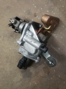

I have a z3 trans mated to my K20/24. I ended up using the shifter from a regular a2 trans. 3 of the 4 holes worked. We just JB welded the other corner.
You will need to get a yellow box to get the speedo to work as the z3 runs a different speedo ring gear or something along those lines.
Been too long, memory is foggy.
I should still have the parts to frankenstein a proper shifter for the z3 trans.

I did not know 3/4 bolts lined up
Just an FYI
you can't buy those Shifter Mechanism's new from Acura/Honda
so if you're going to go that route, you'll have to find a used one
