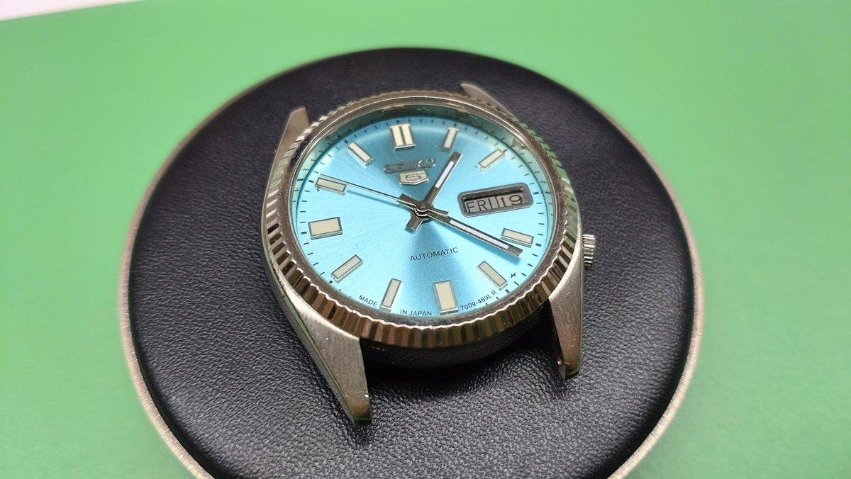

Look at what arrived in the mail today!
I quickly took a look at it, and here are my initial findings
First of all, I'm pretty sure this is not a Seiko watch. The Seiko 7009A movement is real, but the (brass) case, dial, and hands are not original.
Since those parts are pretty new, that stuff was in mostly good condition.

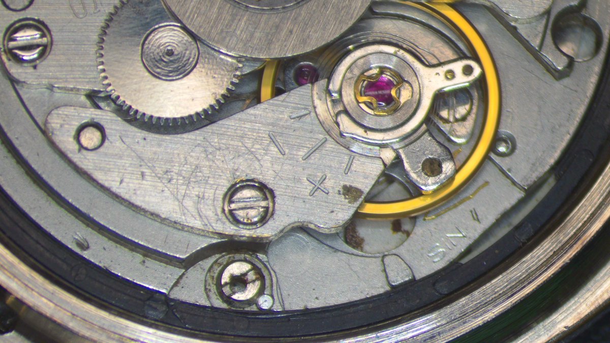

The movement is in pretty rough shape though
You can see lots of scratches and crud everywhere, and someone scratched in a giant "N" under the balance wheel (or is it a "Z"?). That might even be rust down there to the left of the "N", I'll take a closer look tomorrow.
But it runs, and the calendar seems to be working, so we should be able to get it running in a usable way. How well does it keep time?
Not too bad actually. The current rate is less relevant in terms of repair, but you can see that it clearly isn't keeping good enough time to be useful, gaining 3-4 minutes each day. It's not magnetized. More concerning for me is the amplitude and beat error, both of which I'll try to improve with the service. But as off as the timekeeping is, the lines are straight and parallel, meaning there's probably nothing seriously wrong with the balance or wheels. Everything is probably just extremely dirty, but I'll take a closer look.
Another issue is that the automatic winder doesn't work well:
You can see that the pawl levers are not able to rotate the reduction wheel with a light spin, so this does not wind the watch. It does work with more force (like shaking the watch while assembled) but this will need to be looked at as well
So yeah.. this thing is real dirty
But it's going to be as clean as new after service. I just hope I can get everything else running well. Should be a fun project! Will keep you guys updated

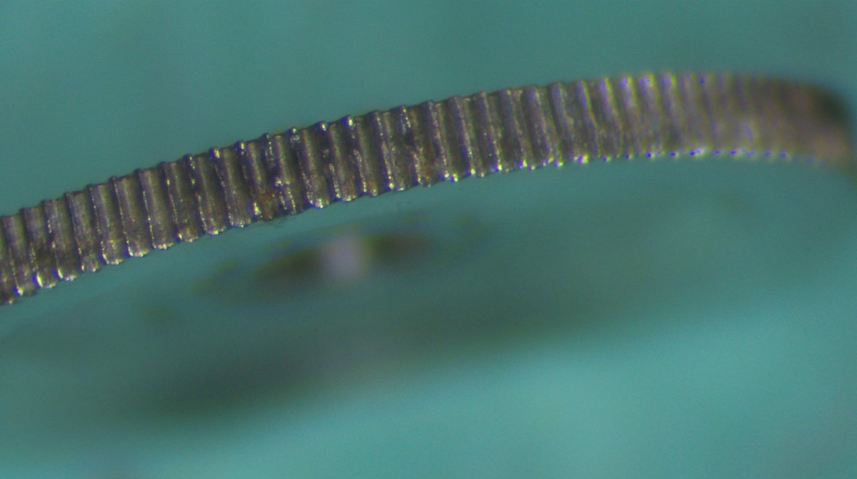

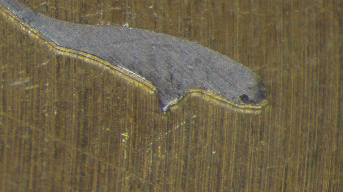

Inspecting parts to see if there's anything that is so trashed it can't be useable. Of particular interest is the auto winding system "MagicLever" as that wasn't working when it came
I put each onto a brass plate, and inspect it under high magnification with titanium tweezers. These metals are as soft or softer than the parts being worked on, so they will resist scratching.
First up is the ratchet wheel, part of the winding system that was not clicking over
It looks pretty beat, but should be OK. There's no missing or worn gears, but there's a touch of rust
Looking at the pawl lever and reduction wheel, these look real rough
These should be replaced.
I did test them out, and they do work though. So just cleaning them was enough
Inspection continued, and we ran into an issue:
The center wheel is cracked! This will be replaced
