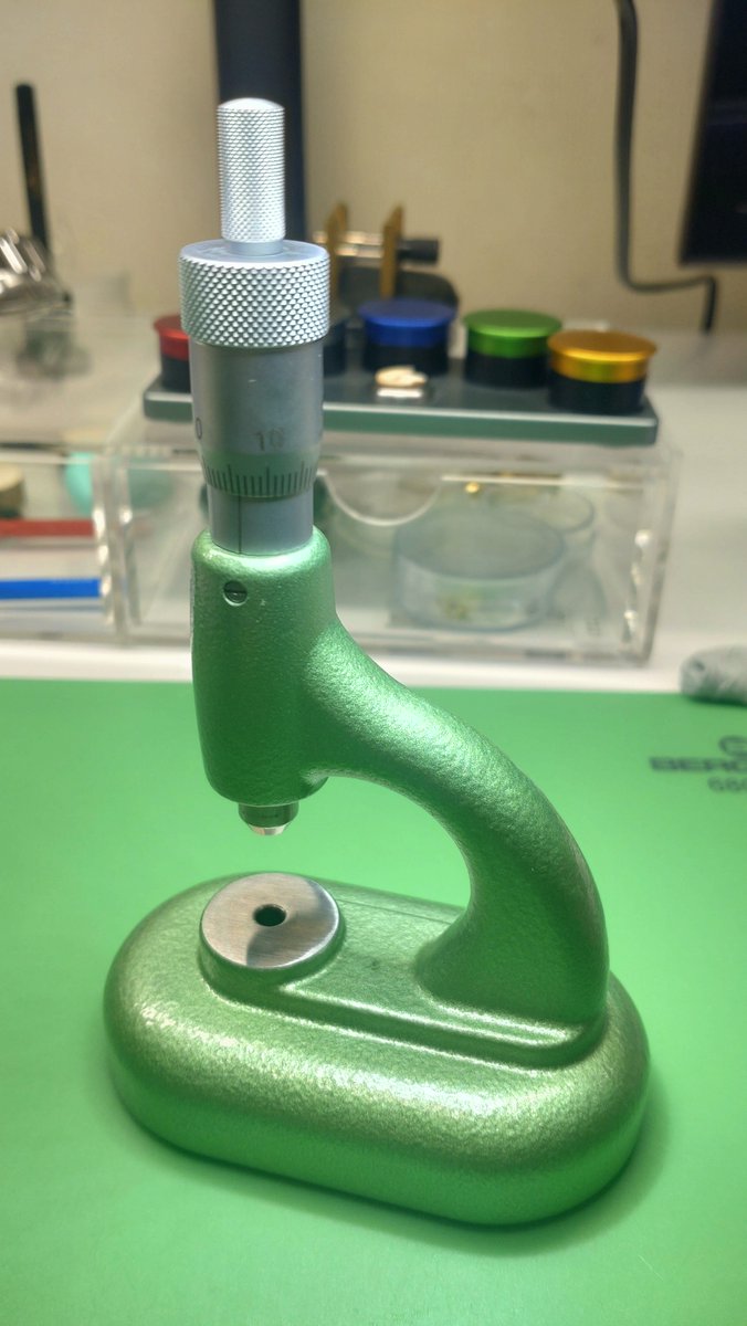

Got a new tool

Got a new tool
Finally something that i can use to measure my..... uhhh
Old 01-25-2026, 08:53 PM   #140
Posts: 55,012
It's not one of those $1000 Japanese ones so its tolerance is only like 0.02mm, so I'm not sure if you'd get an accurate reading

Failed 564 Times in 316 Posts
thats generous, thank you!
