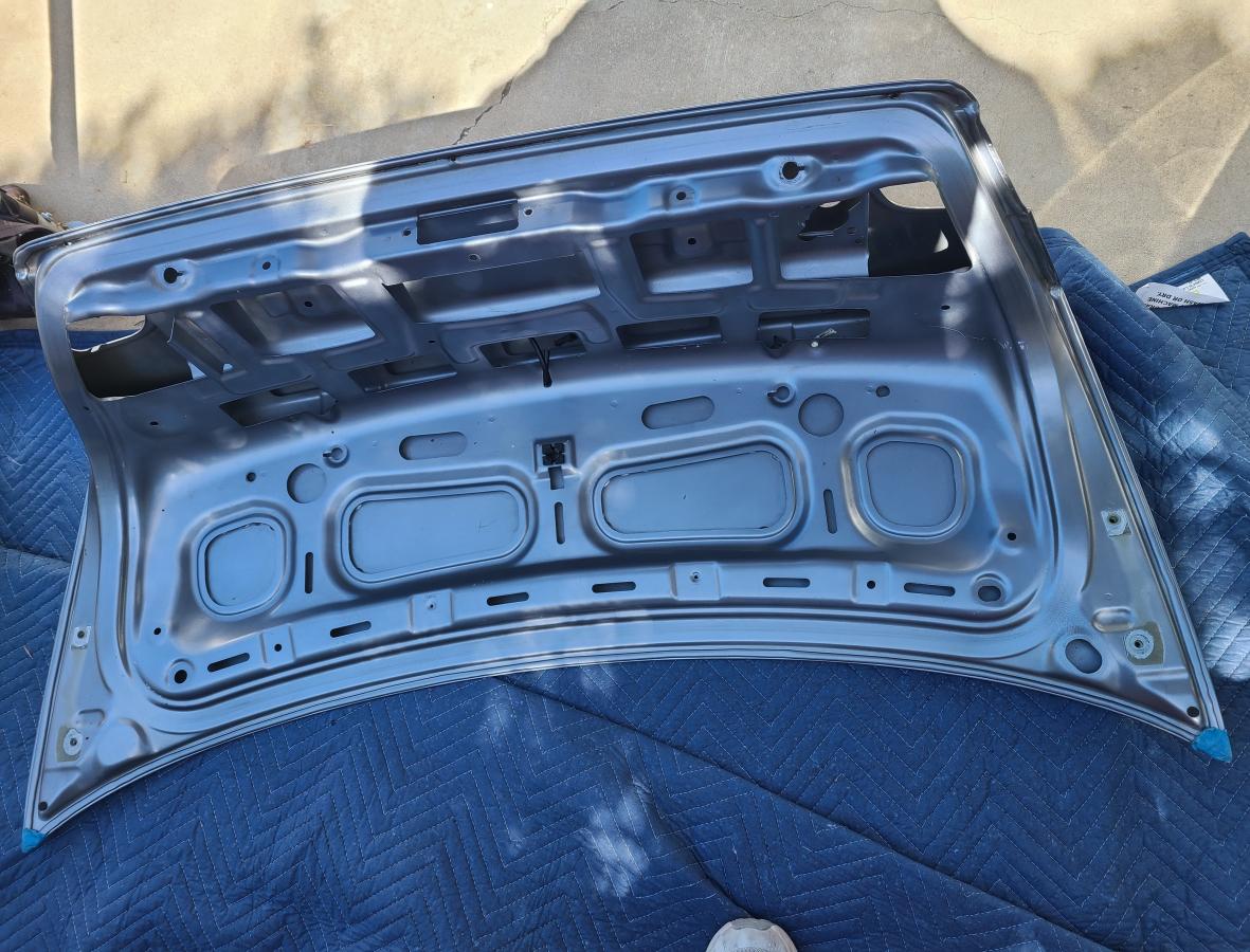

Inside of the trunk wasn't fully sprayed and it bothered me initially but after sleeping on it I figured I could accept it as the trunk liner covers it up fully. Funny story is that I searched far and wide to find a blue trunk specifically for this reason but after I bought it is when I realized it had been resprayed before and the original colour was silver
https://i.imgur.com/0XSxd9C.jpeg
This is what a factory trunk looks like
https://nam3forum.com/forums/filedat...9&d=1741280711

Even OEM paint don't spray inside fully. Look at the underside of your hood or fenders, I bet there is no metallic from the factory.

Not true. If you look at the reference photo of the grey factory trunk above, the inside is painted the same body colour, sans flake and clear.

Inside of my trunk isn't sprayed fully. It's factory, same as the hood. Not saying that's the case on your car, but its pretty standard practice so I wouldn't feel bad about it. The nibs, whatever, but the scratches are pretty bad. I'd at least ask them to polish it and see what can come out.
