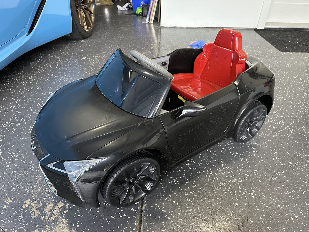

Speaking of paint. i didnt do a very good job painting my tiny ratrolla's seat. Now im worried ill dick it up painting the body.
Anyone know of a guy who can do this professionally and not charge me like 1k to spray a toy car? or just yolo it and spray it for lawls anyways since the damn toy's only 100 bucks.

You went way too heavy too fast. You have to lay down like 3-4 really light coats and let it flash.
You gotta strip that and start again.
Clean it with 99% iso, prime it lightly. Your first coat should not even cover all the original color, light and slow is the key with spray paint. You can't cover mistakes with more paint.

Yea, too close and too heavy, you have to be patient and let each coat dry. Which shouldn't be hard as it's pretty warm right now.
