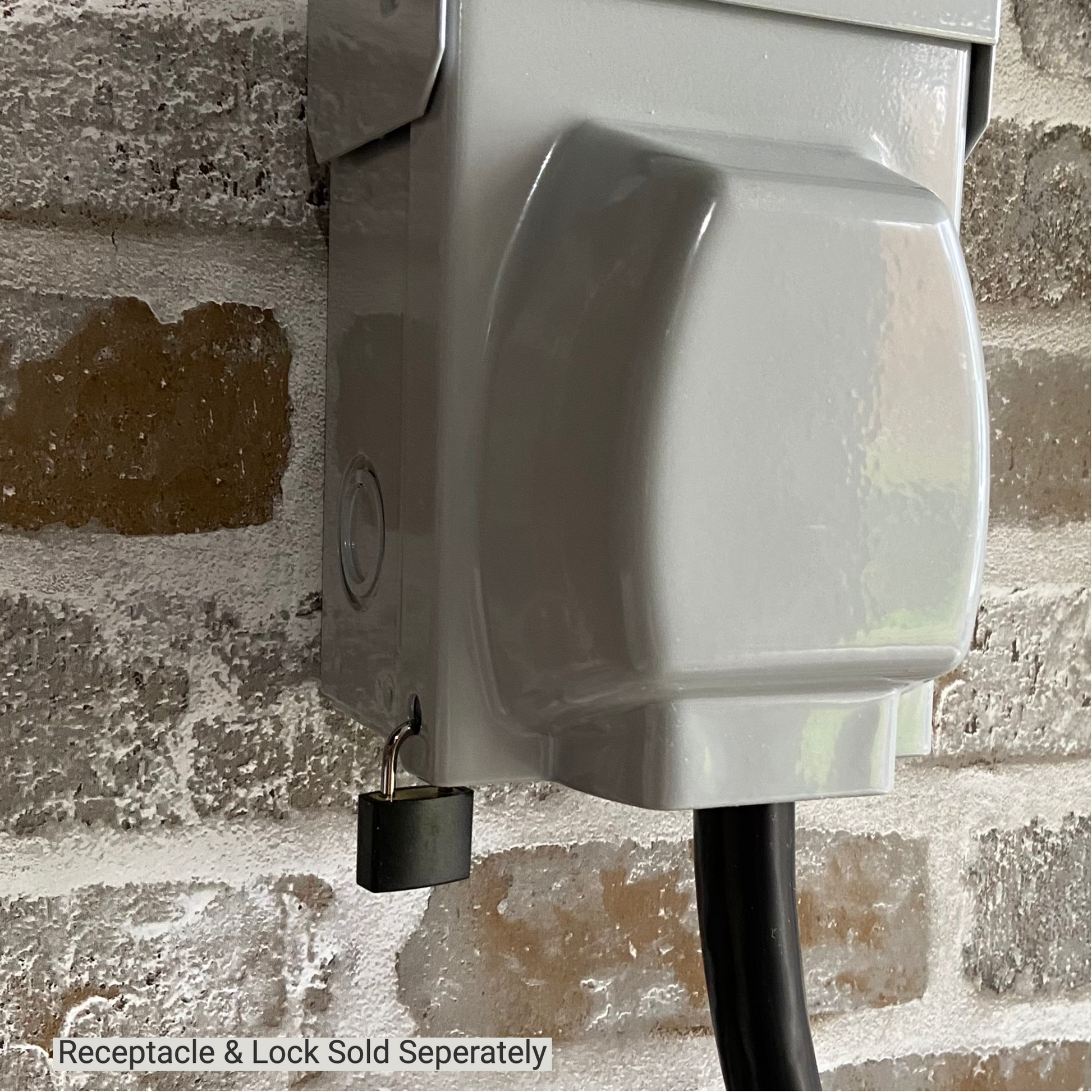

We were also given this to ensure it's locked - so neighbours can't tamper or remove. We have it inside our garage so i'm ok.
1) $600 to pull wire from panel to garage - 25 ft copper wire + drilling.
