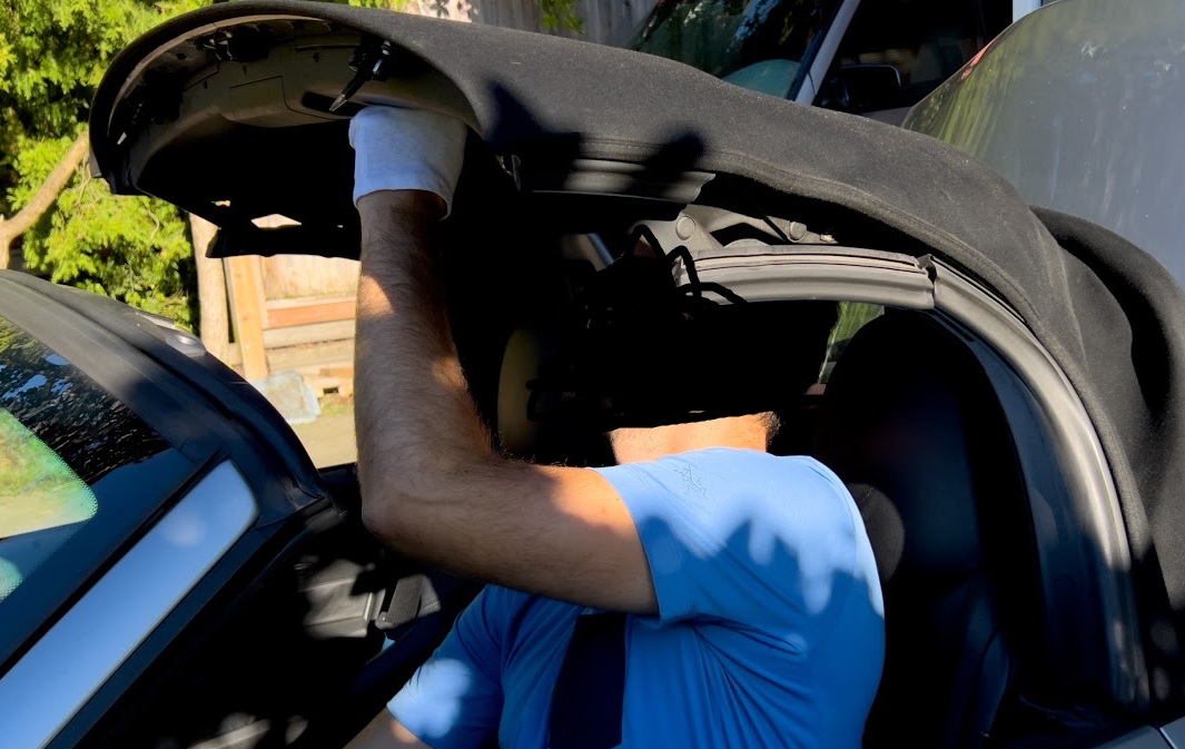

Behold my latest exploits:
So Z4 power top is broken and BMW wants to remove the top, drain the system and replace the entire pump unit. I don't even want to know how much labor is as the part alone is $800.
Useless Z4 roof repair info:
Remove the entire pump assembly from the cubbyhole. Turn the unit upside down to prevent air bubbles inside the system and remove the motor and “spacer” held by two hex bolts. Remove the plastic pump gear and the metal shim carefully. Split the spacer from the motor with a mallet and remove the motor mounting bracket held on by two more hex bolts. Go on Amazon and start comparing generic $90 mystery motors till you find one wit the correct shaft length and key grooves. Reverse all these steps and fill your reservoir with jack oil via a bubble tea straw.
You just saved yourself $2-3 grand. Thug life.

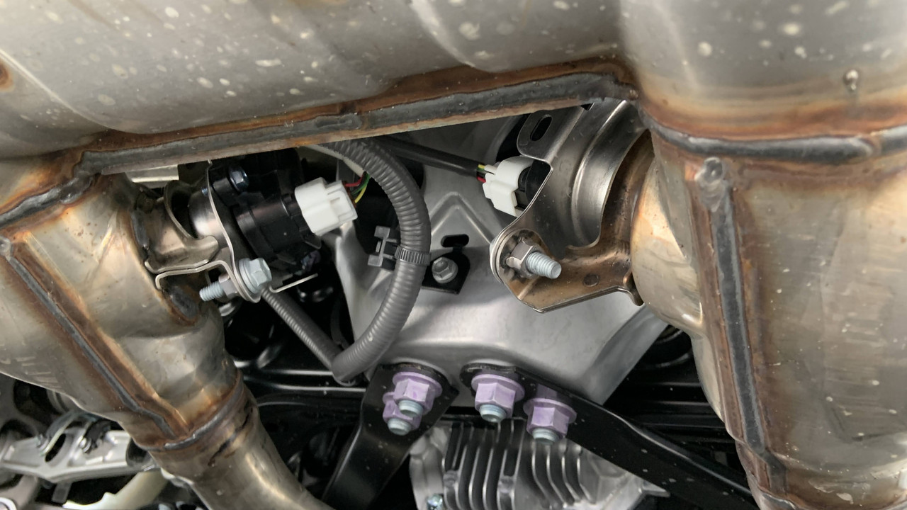

I unplugged the valved exhaust and tapped up both connectors/connection points. Luckily no check engine light or error codes.
Now the valves are always open and it sounds that much better for it (if youre reading this cain ignore everything i just wrote).
Look at that hobz! You can diy!
I wouldn't touch anything electrical lol that's too much for me

bro.... i shoved my huge fat melon of a head underneath my car, pressed two clips, taped off said clips and removed melon head from car anus in under 5 minutes. I wouldnt call that DIY. What you do is DIY.
p.s. this is all because roastpuff's wife said my car was SO QUIET when i left the meeeet. Oh and she mentioned its like a blue Del Sol (props to your wife bro!!! <-- no sarcasm, shes really nice and glad to have met her)
Might be a good idea to put some dielectric grease in the connector to prevent corrosion and then use some good electrical tape
thanks Jc! i didnt even know about this stuff before.
