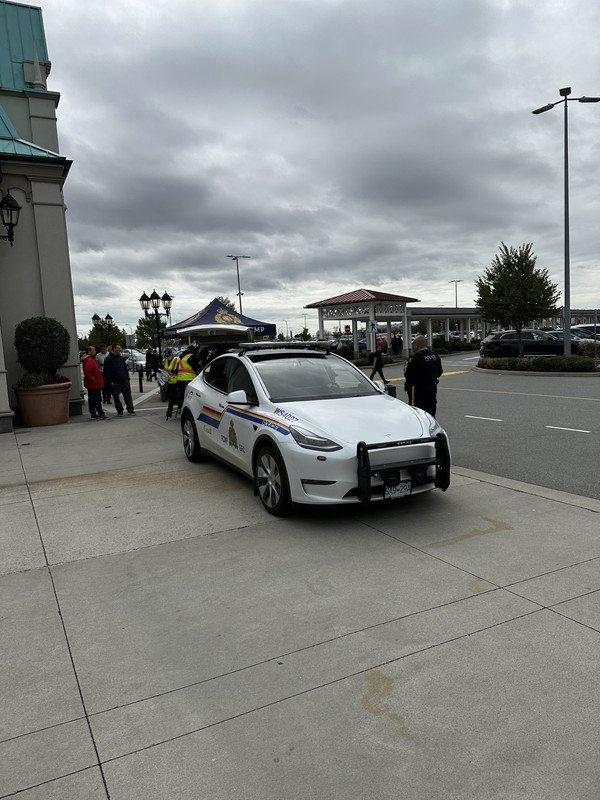

Richmond RCMP just added a model y to its fleet. https://vancouver.citynews.ca/2023/0...rcmp-tesla-ev/
Badhobz 04-28-2023 06:28 AM
It was at the outlet yesterday. They have some sort of a po po don’t leave shit in your car event.
